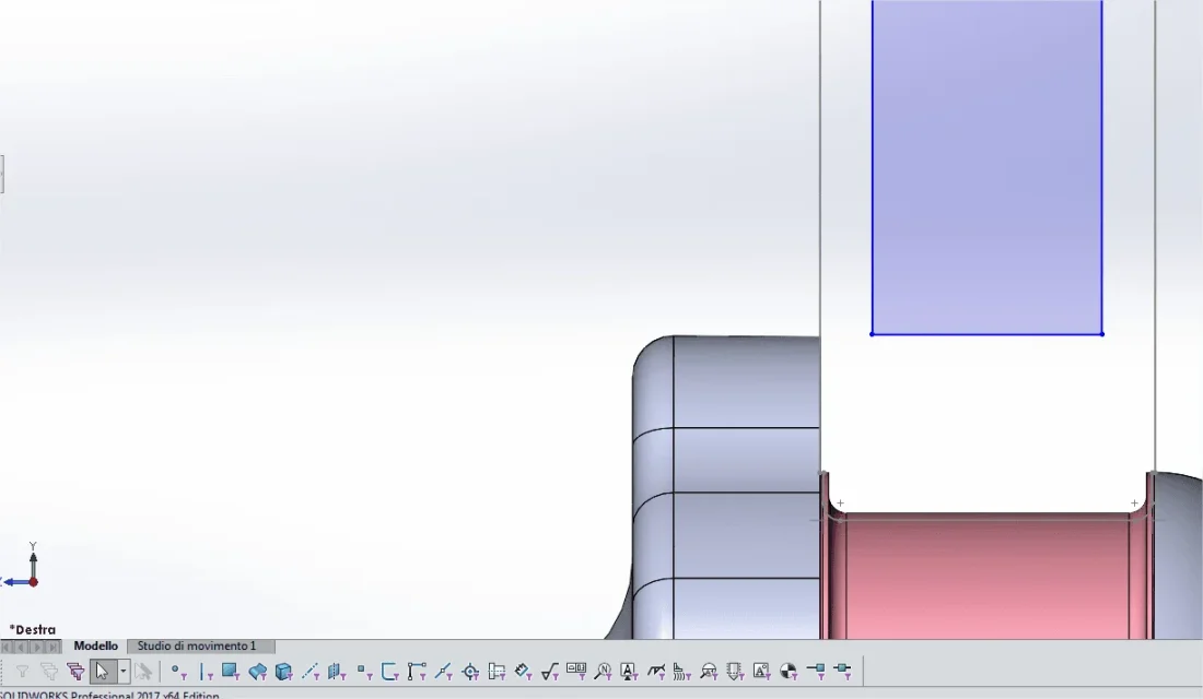

this morning sw decided not to cooperate.
after drawing a few lines, reactivating the filter function (f5 ) I find myself in this situation
1550216522599.webpthere is no way to restore all filters or reset them completely.
closing and rebooting:
1550216700278.webpAm I stalking something?
The situation is not clear.
first image are enabled only those filters and you can't change the selection status (Do you have any buttons associated with specific filters?) tried with f6?
second image seems all right... .
Where's the problem?
in the first image even resetting filters was not going to reactivate them all completely. remained blocked, and not selectable (in gray).
even with f6 there was no way.
only way to solve: soft reset of the software.
I then rebooted the pc and the problem no longer came back, which leads me to think more about a joint malfunction of w and sw than just sw
