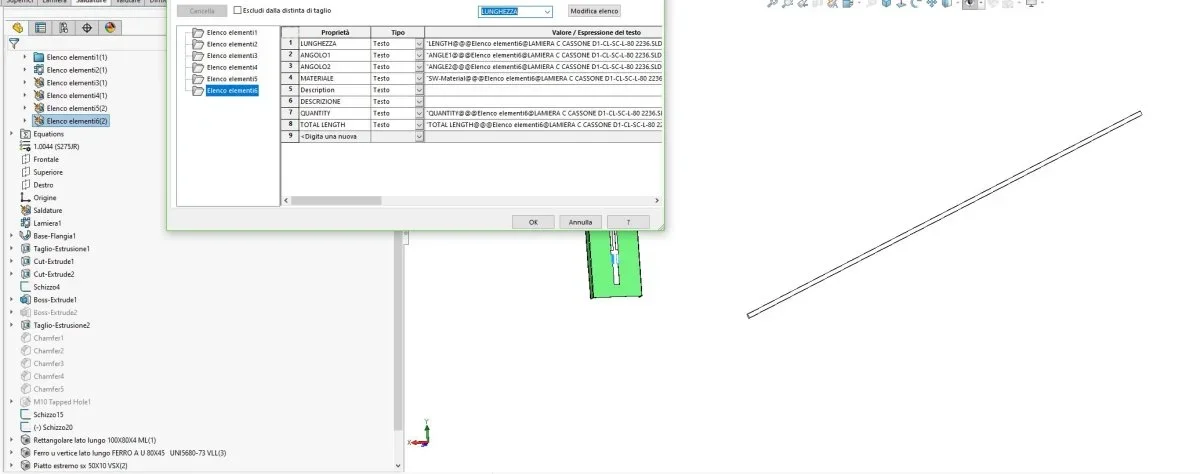

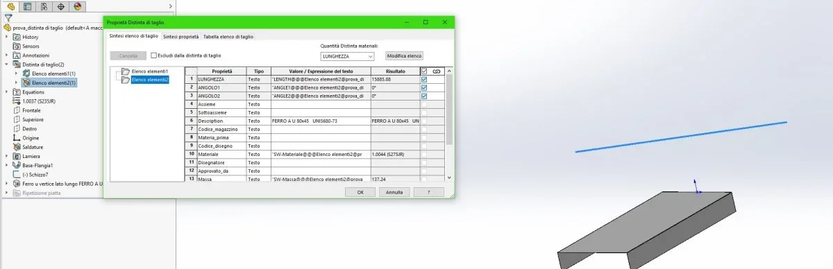

Attached cutting table and properties multibody file cutting table that I don't care about properties and proof where it does. same profile.

I meant first picture of the post #4, which is called "component with non-complete cutting distinct"
