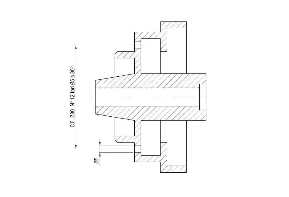

I took 18, exam gone: I was a little unfortunate because the piece was not simpler...but by the way: do you know if a tree can be listed in series?
Attached the piece, I had to extract what I labeled in red with number 1...
It went as it went, but from today, put in place pencil and paper millimeter, I will still try to learn a real competence in the matter of drawing, a basic competence that will be indispensable to me in the future. to do this I will try to exploit the possibilities offered by the pc and various programs.. .

All right, it's gone (and sincerely I'm telling you I wouldn't bet on it:wink:) and I'm giving you compliments (but forget the academic kiss:biggrin:).
But in fact, do not do what past (...al fur..) the exam forgets everything. try to deepen as soon as you can.

apart from the fact of making an error in the representation of threaded holes, with the thin line inside the hole instead of outside
aaaaargh :eek:!!
inexperience, inadequate attention perhaps.
no, usual "cecity" and disconnected brain:biggrin:
That's what makes me look like. What's the point? to delimit the edges, edges from the surrounding empty space. inside a hole there is the void, how can you just think of putting on the thin line? besides enclosed between two thick. there ends the material, is the limit of your particular, is a well defined entity and must be properly underlined, beyond there is the barter; There is nothing to study, it is pure and simple logic.. and it is also bad to see, the doubt comes only by throwing an eye (already, always those..).
concerning the standard quotas on machine parts,
It's not that it's "forbidden", it's not a real mistake. But it is good to avoid it and to resort to the parallel to help the work of the speaker to the machines (already, but this to understand it you should know a little how they work and I do not think that for now you have done much about it. and it is true, on the texts is normally reported, but it is also explained if possible not to use it), this to minimize any errors of reading and calculation, especially now for programming cn.
we say you were right (almost) both, but the prof. more (which however is what he should have explained.. Is that the same thing that she holds?
greetings
Mar
the thin liinees to represent the thread, but they went external...however it was the same prof...
I think you don't have to do all the section, just cool half (like sampom but only half).
the only problem is that in this way the holes are not very clear, and it probably takes the front view. or better the professor could break for the front view, I consider it superfluous and would suffice a quotation made well

I don't understand, should we do your exam? if you have read all the ascussion you will have noticed that it is recommended, correct, directs to the correct solution, but you do not do the job instead of the applicant.
also in the 3rd post is written as follows:
"being a solid revolution would suffice a section along a diametrical plane... I recommend not to forget the rotation axis (it was always indicated for the trees and all these types of solids).
the problem is that here there are also all those pins on a face and so you also need a side view that shows them (I recommend not to forget the circumference on which the holes lie and indicates with what angle they are spaced). the fact that they are passing you see it in the section before.
As you of all the drawings see only one view, unless you forget to attach others, it is evident that it is cylindrical pieces, otherwise you would not have a way to obtain the third dimension. unique incognita are the fixing holes
so all you have to do and copy what you see without the surrounding geometries considering that the tilt change of the dash indicates two different pieces.

I should do the extraction of the detail in the minimum number of views and sections. from what I understand most of the pieces are symmetrical axial, therefore only one view and one section should be enough. my problem is, that having not done other mechanical studies, I cannot interpret the particular and therefore consequently extract it and reproduce it in sight or sections. I don't have to do all the drawings, but 1 or 2 details per drawing (by hand). I was wondering if anyone could give me any indication by doing a sketch, just to realize me. Thank you for the massive answer.
radio: I introduced myself, you have to forgive me =d
It is not about mechanical studies or something, but about being able to make projections.
the sections you already have; to do the other view and to understand the concept you take a cylindrical object (a glass, a bottle cap) and look at it perpendicularly to the axis, this is your section. Turn 90° and you have the view you have to get. is nothing difficult, define a common center and plot of the construction lines corresponding to the edges of the drawings section of the tangent circles to these lines. search on google "orthogonal projections of a cylinder"
