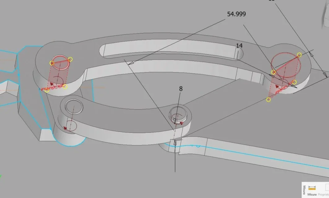

I don't understand what you think you do, the thicknesses aren't consistent, the contiguous faces can't match.Vincoli.webp
I know that the thicknesses are not consistent, that I will change later, what I wanted to do at the moment was simply to bind all four components. You say I can't do this until I make all the thickness match?
Of course, however the system is already fully bound, apart from the pins that are free to rotate.Vincoli2.webpremember that it is always better not to leave labile constraints, those pins better to block them.
This is a very simple set, when it becomes more complicated, uncertain constraints will become a source of difficulty in movements.
This is your situation:Vincoli3.webpshould be soVincoli4.webpsee that the rotation arrows on the two pins have disappearedVincoli5.webpno one does it, because it seems a waste of time, but it is the basis for having smooth and safe movements.
