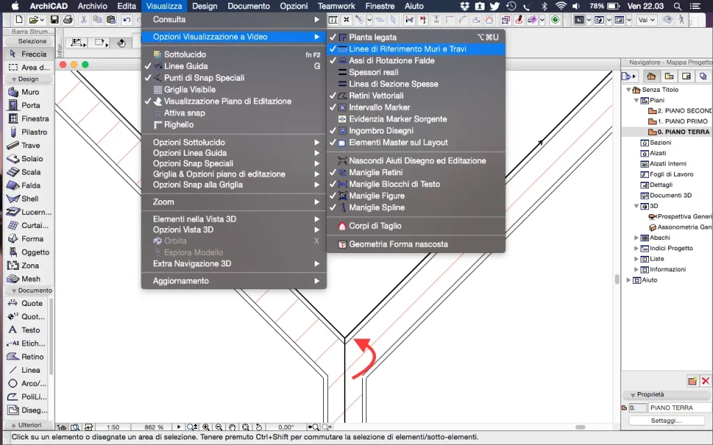

I have a problem with the intersection of the walls in archicad, as seen in the image, the vertical wall does not intersect with the corner wall despite both on the same layer and has the same characteristics (priority etc...)
How do you intersect them?

check where the reference line of the walls is, and connect the vertical wall with the other two.
