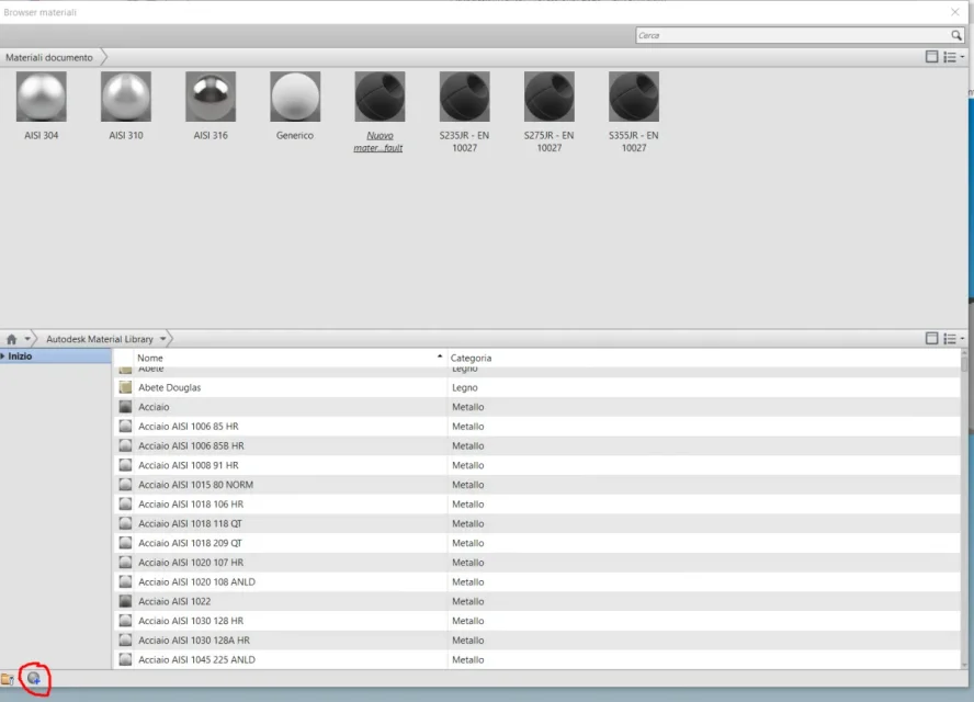

I better explain... I grow the material "s275jr", I put density 7,85 g/cm^3 and the check to the interested party though if I go in his iproperties in the section that concerns the physics I mark density 1 g/cm^3.
the management of materials in inventor is one of the main problems in my opinion... zero intuitive.
anyway know that somewhere, hidden there are already s235, s275 and s355. I'll set you up some screenshots hoping to help you
