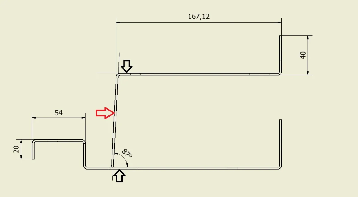

Good morning, everyone.
Needed to quote the distance between the two black arrows, but the altitude must indicate the distance not vertical, but parallel to the straight indicated by the red arrow, is there a way to do all this?
Thank you very much to all in advance.

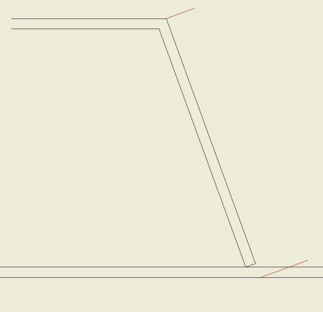

I would do a sketch on the view, I would design two hyphens (red ones) as you would with autocad and I would quote those

touch the horizontal line where you have the black arrow down, dx key, intersection selections, touch the tilted line that refers to direction, repeat the procedure for the opposite side where you have the black arrow up.
Thank you very much, just the solution I was looking for! :
