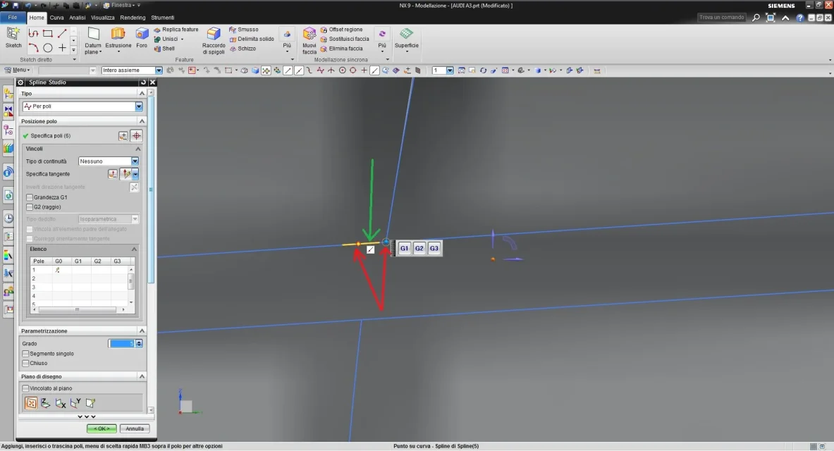

I'm learning to use nx 9 and I came across this problem that I can't solve and that I've never seen in other cads.
using the spline studio command I would like to place the end point curve at a specific point so that there is continuity over the curve below (point marked by the green arrow). as you can see in the attachment, using the "point on curve" link, I can place the end point curve only at some specific points of the horizontal curve (marked by red arrows). Looks like the curve doesn't have enough resolution... Is there a way to solve this problem?

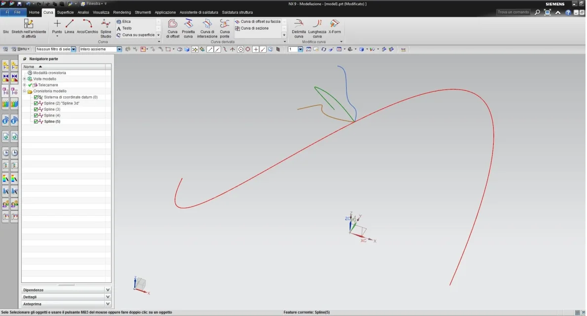

I simplify this by posting another very simple design in which I have the same problem. all the splines are performed randomly with the command "studio spline" in space 3d (so not in a 2d plan of sketch) (images 04-05).
in the image 06 I made the enlargement of the lines. Taking as reference the green line, I would like the blue and orange lines to be closer to the green line keeping the bond that all curves (green blue and blue orange) have the spline starting point lying on the red line.
My problem is that I can't approach the curves to more than 0.226 mm each other by keeping the bond that the initial points lie on the red curve (the tolerance of 0.2 mm is too low for some types of drawings).

place a small film here https://www.youtube.com/watch?v=haa385-hq8g you can see some things, one for example that my command is different from yours as I set the full view (rotellina at the top left). then see that you can bring the point where you want with the handles on the spline on which it rests. n.b. just one click.

ceschi1959: I thank you for the tip, with that method I managed to solve the problem:finger:
