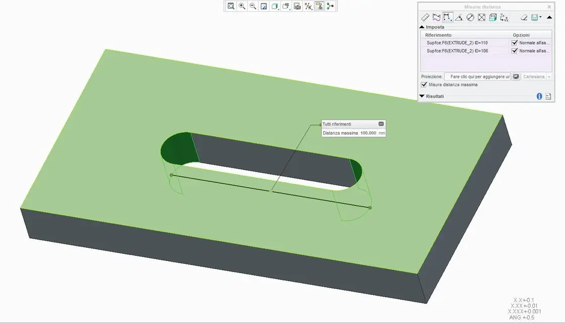

not unfortunately in the version you use was not present the distance "maximum", so you can not get it in the simple distance, a smallness that in I create have added as you will see from the image.
distanza.webpHowever, you can overcome this "mancancy" if you have built the mathematics by inserting in the asola a reference share for the maximum distance, or if it is a mathematics imported from the outside a curve where you went to measure the length.

of nothing, you are also quiet, in creo they have greatly enhanced all the measurement part and above all improved the management of the same, if you see in the image they have consolidated all the commands in a single toolbar,many fewer clicks... :rolleyes:
