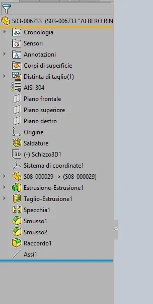

to lighten the project, I am importing the skeleton even in the simple parts....the problem is that if I add a sketch, plan, axis; I activate them on all sides and I have to go to hide them one by one.
- do you know if you can set to keep all entities of imported parts hidden? (not with the eye turned off, otherwise when I need plans I turn on a hundred)
- or. at the end of creation of the part you know if I can with a command delete the imported part? like a "elimina/mantieni corpo" what do I keep my previous functions?1614325234353.webpgrazie
I don’t think it’s possible that they are automatically hidden at creation; you can use the filter over the feature manager to view them all and make selection easier.
you have already given the answer; if there are related functions should use the helimin body
no only for those with special geometry, lightens compared to using the subaxieme skeleton
not only for those with particular geometry,
