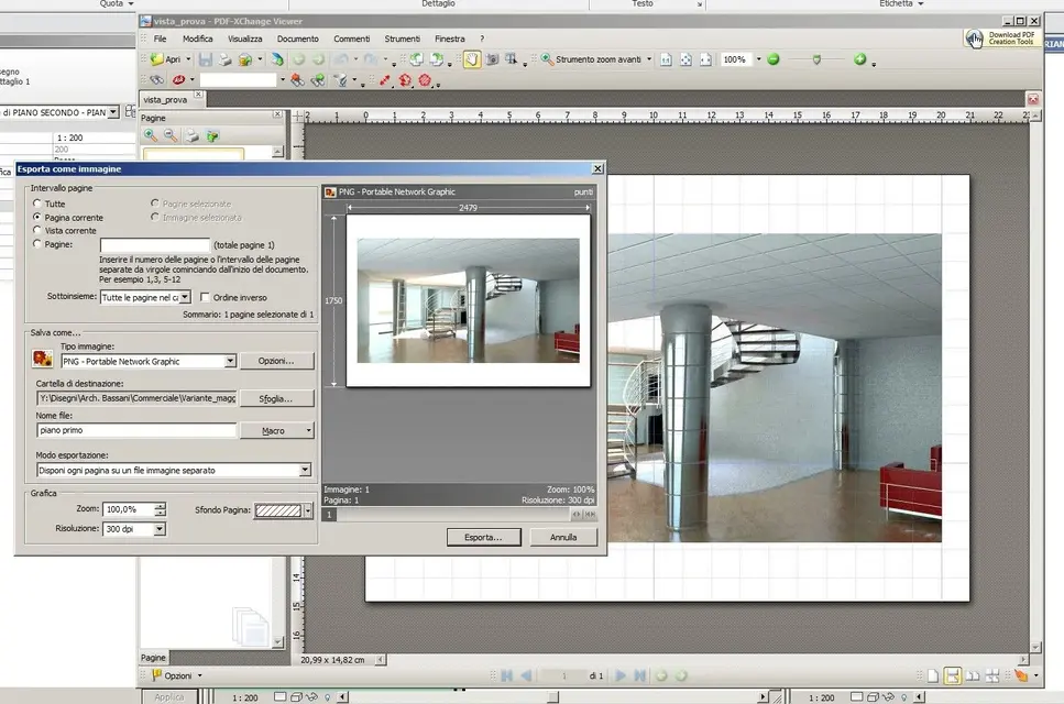

print the black and white view in pdf, with "pdf-xchange viewer" you have the option to export as an image and if you choose the png format you can make the white background transparent. then in paint program overlap the two images by deleting the lines you do not care about
the same thing I think you can do with some paint programs.
I do not use photoshop but I think it amounts pdf and then save them as jpg or other format
or you make your render, save it in the project. opening the rendering view, you can overwrite the image with lines, but I think it is more problematic to position the lines in perspective
