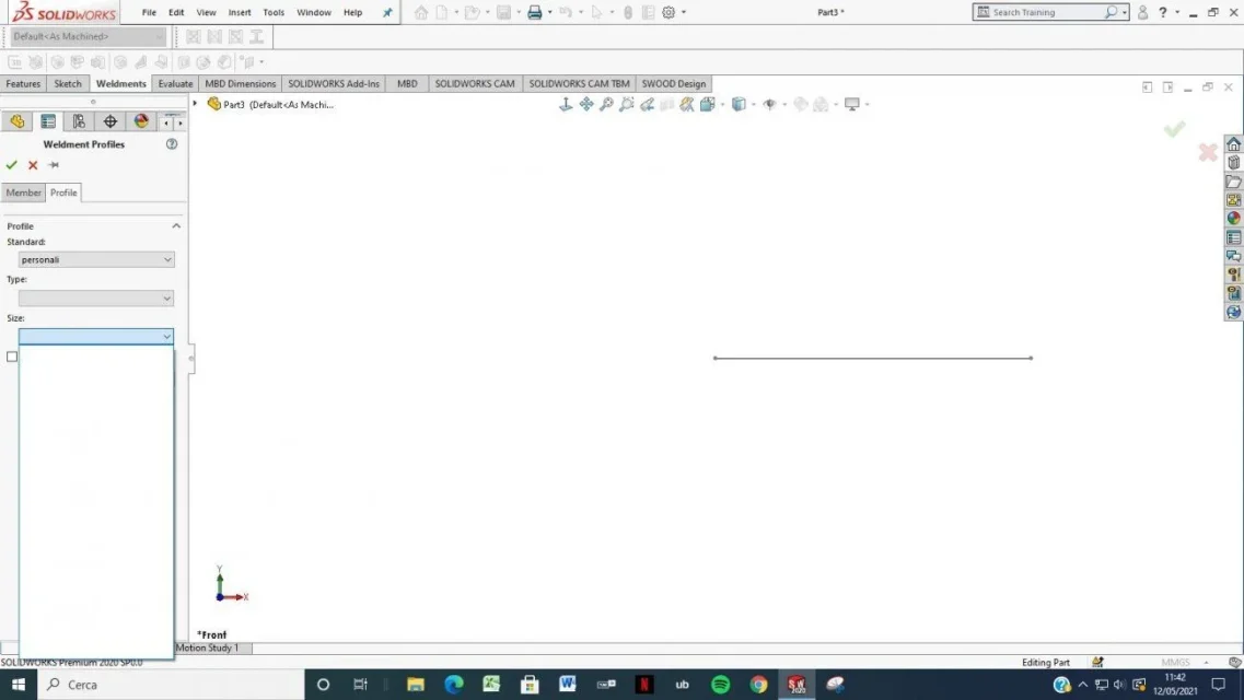

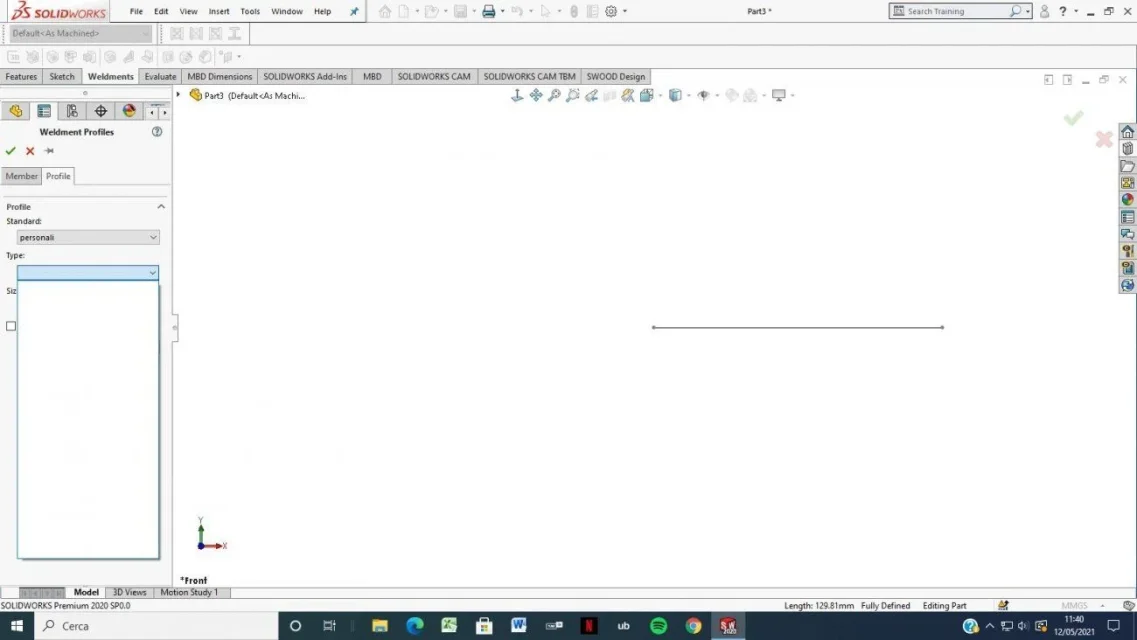

good morning to all, from a few days I went from solidworks 2018 to version 2020 , I have a problem with structure system , in the sense that apart from the sldlfp files that are created during the installation , creating new profiles following the correct procedure , they work if I adopt structural member system while if I adopt the structure system, the name of the folder where the new profiles are located but in the type selection and measure the fields do not appear, they are better, they are empty, they are better, they are enclosed.

Thanks for your advice, after making various configurations of the profile, now the fields are recognized, see annexed, but when I apply to the test segment, it gives me an empty library, both in structure system and in structural member, why, where is the mistake?

good morning mass, as written , than before, i.e. using single sldlfp files for each profile created , appeared folder name where I placed them, but the fields of the type menu and measure appeared empty, then doing as suggested only sldlfp file containing various configurations , width height and thickness the fields type and size are recognized as seen in the attachment, but when evidenzio part to insert profile it is from me signal what error
solved problem , I changed table configuration of the file sldlfp created during installation of the program adding the measures I need , although it gave message that is only reading , saved in the desktop and then recopy it in the original directory. Everything works, thanks for your suggestions.
