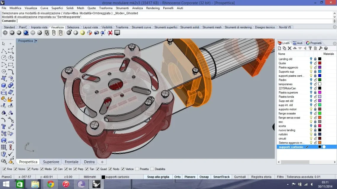

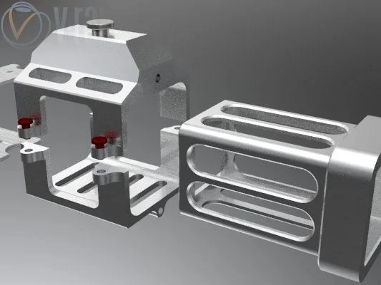

Thank you. I've made a lot of progress from that first project. I now design any element I need and have in my head. I work a lot with polysuperfici and now I apply materials, I make rendering. I'm at 50% of the project I have in my head and with rhino I feel good. You seem to have a lot of experience, what software would you recommend? I recently started looking around other platforms but at the moment I learned pretty well rhino so I stay here since I can design quickly and with excellent results what I need. like this 4.webp blocco gambe alluminio2.webp
