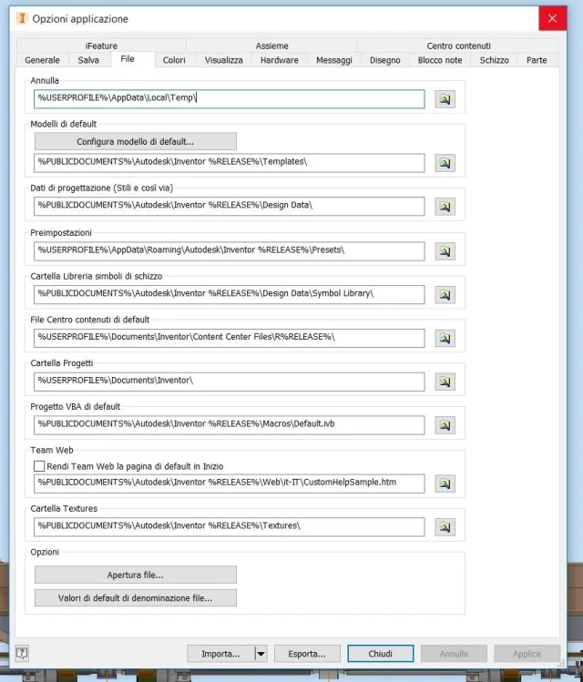

our engineer advised us to move the used library, in the main directory of our files so as to sync them too. Who can tell me how to do it? I know I have to change the settings of the project file by changing the folder, but I would like to have a confirmation and maybe clarification from someone. and another question is: changing the folder to all three computers, all files created before changing the folder, will they give me problems when opening?

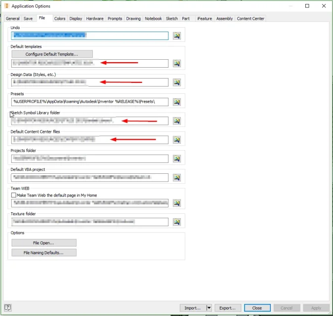

take a look at the screenshot:2019-06-27 09_58_50-Autodesk Inventor Professional 2019.webpthe red arrow indicates common folders on the server.
from this moment all files created by everyone will be accessible to everyone.

find existing folders in all local pcs (I don't rich the path will be something like %userprofile%\documents\inventor\content center files )
select everything (for all pcs) and copy to the new folder on the server.
I have all the drawings in a x folder of the computer with many other folders inside. when synchronizing, we only synchronize the x folder. You tell me the red arrow indicates the common folders on the server. What do you mean?
You can politely explain to me how to change.

inside this folder x we created an inventor resources folder with sub-folders templates, styles and contentcentre.
