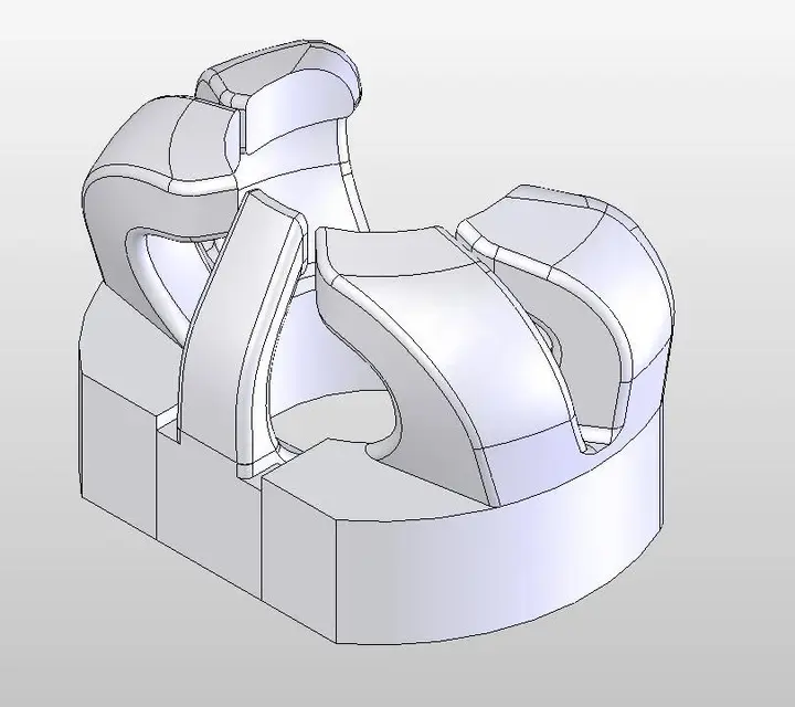

I had a good time designing 2t engine cylinders and here comes my problem.. .
:eek:
I practically have to be able to combine a basic form with a more or less similar set in truthful (travaded). ..according to the trajectories established by me...but the problem is to find the right system to make these trajectories. . .
the trajectories I need to create the two side surfaces, because the other two are given by the surface revolution that you see...
I'll put you two cunts as an example of how the finished drawing should be and where I have to go for it. . .riferimento.webp provaax.webp

I'm sorry. to yesterday; as soon as I had time I would post a couple of files with possible solutions (which are there), but I have 2010 and you could not open them. as soon as I can attach a couple of pictures and an explanation.. But I'm in advance sweep o loft along path 3d.
the topic I like and interest, also I am passionate about 2t and their technique (as you will notice from my avatar:smile:). . Maybe you'll explain how and why you get to those "conformations".

I prepare and design 2t competition... for builders and private. .a time lost (anke if in reality and almost my first job)....and travaseria solutions are related to the type of delivery,volumes,but especially to the ke motor you want to get!
We can talk about it whenever you want!
the travaseria ke see is that of a 125 gp...
If you want to send me the example with 2010 do it quietly... on one of the computers in the office we have installed one to try its integration with plm..onde avoid surprises at the time of normal use. ...
