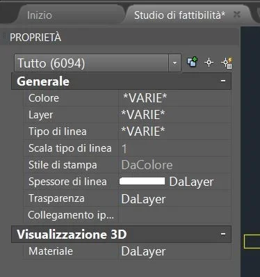

If they select everything in the properties disappears z, so I don't understand where to deny 0?
and sure, where you read everything (6094) you must select the type of entity to read the properties and then you can correct them
I have selected with the mouse of the smaller pieces of the drawing and in this way I see in ownership the z and inside time to time I wrote 0.
