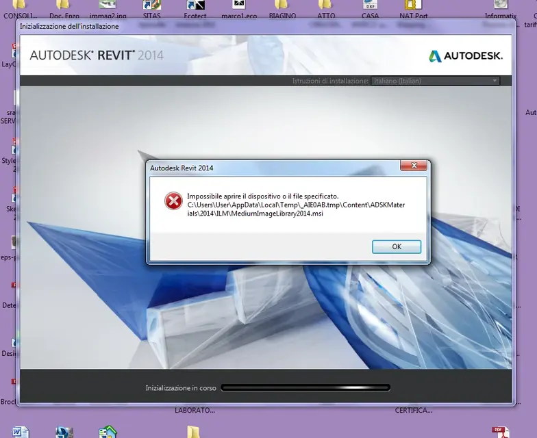

I try, therefore, the installation on another pc. about half of the installation appears the message I attach.
How can I solve the problem?

I don't know if it is applicable to your case, but it happened to me sometimes, in the installation of programs, that "files" allocated in folders with "excessive" number of sublevels (in the message are indicated 10 sublevels) create errors to the execution of the same
that screen is related to the texture library for materials. It has nothing to do with family bookstores. installation must be done with active internet connection. if you are connected and you are still experiencing the problem try to temporarily disable antivirus and firewall
