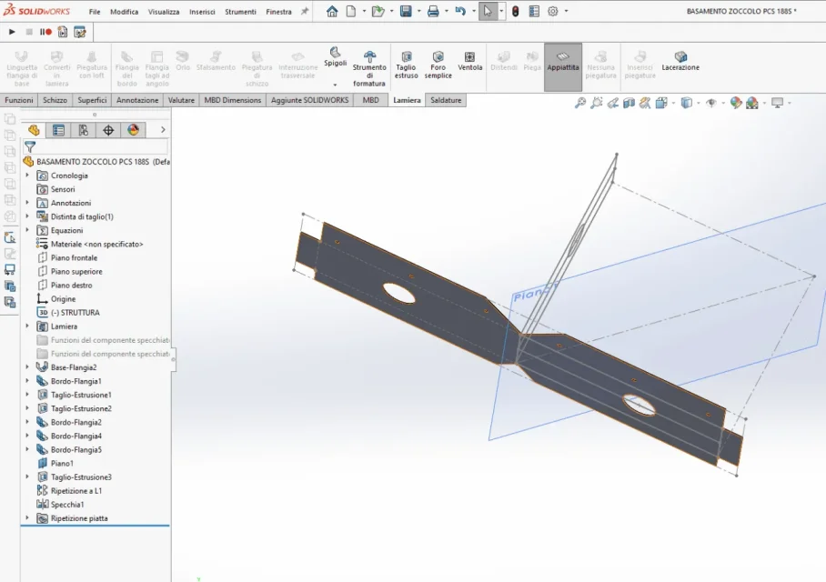

I have the problem that I do not get to flatten in the drawing the view of the drawing 12
Can you help me?
the problem that on the design nn gives me flat repetition
in tiny courtesy.

I don't know where this configuration is where to activate flat repetition.
when you insert a view of a sheet of which you want to have flat development We must have indicate as a view type flat repetition; in this way solidworks automatically creates a configuration (see configuration tab) in the part that activates the function flat repetition.
This method of inserting flat plate views is explained in the sheet tutorial
Hello.
sometimes the derived configuration is not automatically inserted by sw and you have to do it manually
at least more than a few times
go to the default configuration and click dx, add derived configuration and call development or defaultdevelop
reactivates the function of sheet metal that is suspended, usually it is all down to the featuremanager
when inserting the view into the table should appear the configuration where development is present in the plan
I hope it helps
probably because there is a problem in the model.
usually happens when you make the table with the function flat repetition activated in the default configuration, maybe for a quick and then forgotten active control; in this case solid considers the configuration default equivalent to that development and therefore does not propose in the list seen the one dedicated.
other common problem is to create the development configuration from the design environment and then return to the part environment and to mess up by deactivating the flat repetition function without paying attention to what configuration you are working on.
if you can't districate yourself the best thing is to close the design, delete the development configuration and remake as head
at this point these finesses are not necessary; solid creates for its logic a viluppo configuration, but it can well call itself Napoleon and equally well not be derived from the main. the result must be a situation where the flat repetition is active and possibly the underlying functions... if that particular does not require a fold design and should not be inserted into a set, all this can be done even at the default configuration level that works equally.
