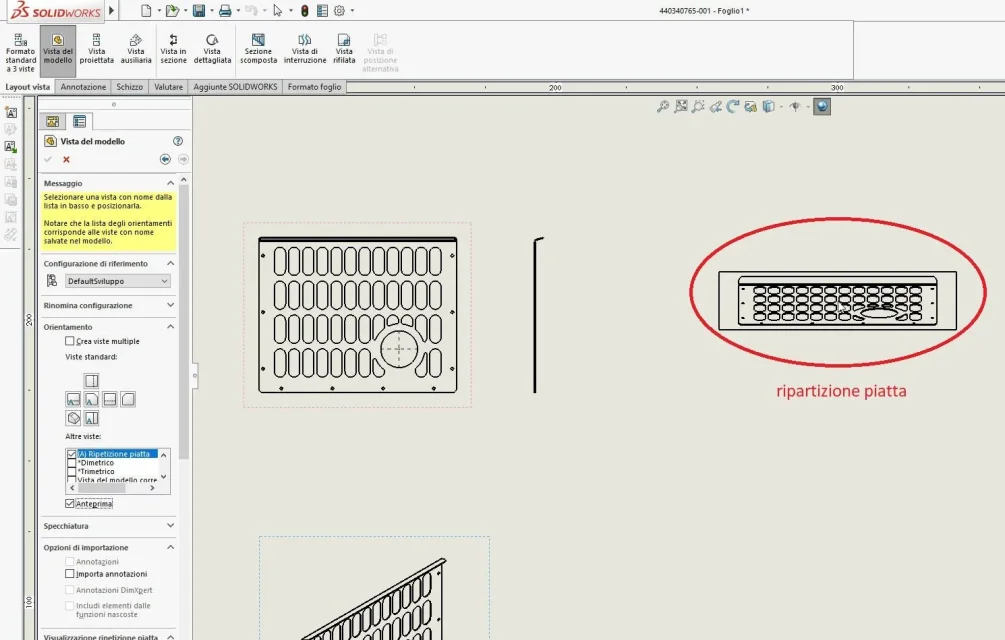

Hello everyone,
I find myself struggling with a problem that I would call strange, as I only match it with this sheet made from scratch.
In essence with only one fold "flange of the edge" I can not insert its flat breakdown in the table, always gives me one of the classic views std.
place an image to make the idea better.
Thank you all in advance for the answers given.

Perhaps the function in the part is suspended.
only with the image how you understand why behavior.
for correctness is repetition flat

how I guessed the flattening function in the configuration default development She's suspended. reactivate it and go well.
to future memory:
- always verify that the flattening works through the appropriate command flattening found in the command bar
- to have a proper functioning of the development process to the creation the sheet should not have the configuration defaultdevelopment; this will have to be created independently to the first insertion of the view flattened in the drawing board
to future memory:
I understand massive, but how do I reactivate the flattening function?
in the model part through the "flattened" command works. .
