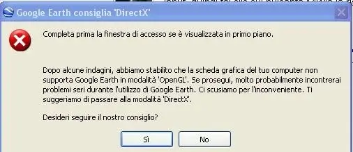

Sorry if I introduced myself I installed google earth on a computer windows xp, but it is very slow, during he gave me information, to install programs that I did, it also attaches a message to which I said no.
What can I do? Thank you.
your card, as the message says, does not support open gl, so you have to switch to directx, so you had to say yes.
take into account that it is very often not recommended for old cards to install the latest versions of google earth, I tell you from experience on more dated pc installations...

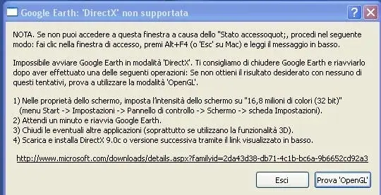

problems installing google earth, I exit this mask, I installed the program suggested by the link but clicking to open it again comes out this mask. What can I do? Thank you.

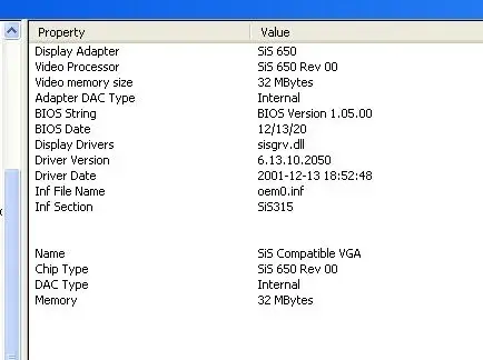

I searched with a program should be these data of my tab, see image.
if it is old I have to uninstall this version and after how do I have that old one?
Anyway I clicked you and should have installed directx9.0c, how do I know if you have installed well?
