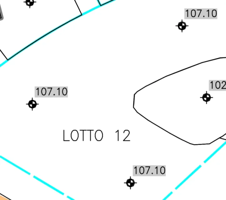

I try to explain, I have a reference block indicating a quota at a point (later the photo). this quota has properties annotative but inexplicably once molding the quota changes value (all this only in one of the two stairs).
to explain better, in model the quota is correct, in the paper space is displayed correctly; Now if mold in scale 1:1.000 the value is correct, if mold in 1:2.000 the share changes (become negative or 0.00), someone knows how to solve?
Thank you in advance for your availability! :

I tried on the flight with a block made in 2 minutes but I couldn't replicate the problem. What version of autocad are you using? Can you attach the drawing?
I'm using autocad 2019, but I tried with the 2021 and the same problem resumed.
I tried to think about it, likely that the block attribute does not recover as value the z position but the insertion point? But it still makes me strange that if mold in scale 1:1000 the error does not show up and at the moment when I mold in 1:2000 the error occurs (and consequently changes the object in model, making a regenerate everything then returns to the correct value). a mystery to me
Unfortunately I cannot share the cad for confidential customer information, thank you for understanding and for the answer!
was present "print" with field update options, I don't know how it is possible. I think the only quick solution is to change them manually.
