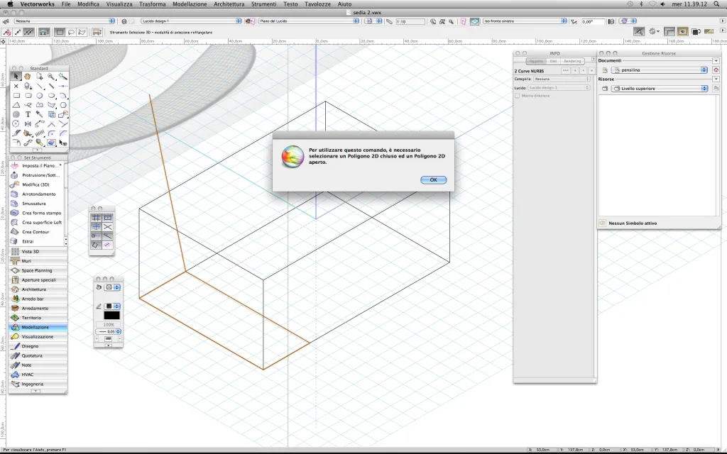

I need help on the profile extrusion command.
design two polygons 2d one closed and one open and then select them and activate the extrusion command on profile but it appears to me a pop-ip that tells me that it is not possible to do it because they are not open and closed polygons.
I can't find a solution.
I think it's weird. the command works both with closed and open polygons.
can you post a polygon screen image and error message?

I'll get you the picture. I don't know if you can help me.
- - - updated - - - -ok for next time I will follow your advice.thanks
I see you're using a slightly dated version of vw and maybe it's due to that.
he speaks to you expressly of 2d polygons; instead you are using the nurbs, which are entities that live in the three-dimensional space.
the latest versions of vw allow that type of extrusions even starting from nurbs. the one you're using obviously not, he really wants 2d polygons.
