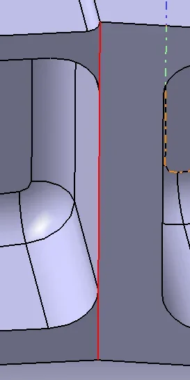

Good morning, everyone! I am a student and I am working for my first time on a casket project, but I am finding difficulties especially in this work:
in practice what I have to do is simply to form a 171° edge between two flat surfaces.
I add pictures of the final piece (with red the desired edge) to better explain:

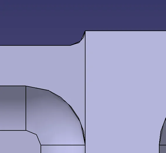

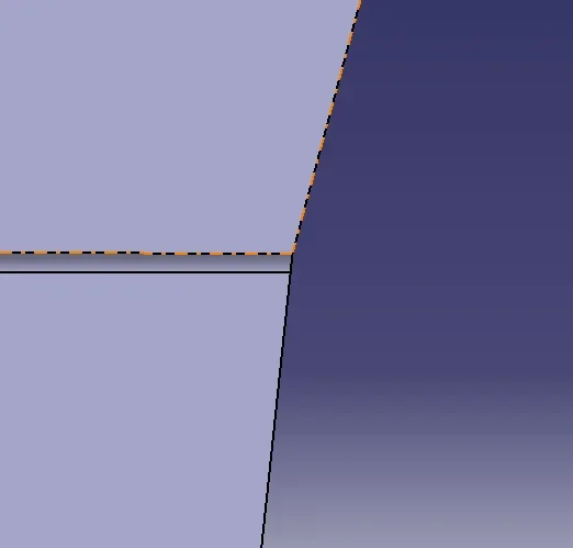

- part 3d3D1.webp-view from abovealto1.webp- front viewvista frontale.webpuse a 4-axis cnc machine with rotating table
I tried to work through facing first one surface and then the other (using the rotation of the plane) giving as a limit the intersection of the planes but the milling "short" going to work the next floor, and I do not know if and the correct approach.
I hope I explained.
Does anyone have a solution?
Thank you in advance!

use the function "fresatura a spiral" - selections like "working area"the normal face to the tool axis and as "verification" the adjacent face tilted 171°. ♪
repeat the function by reversing the selection of faces.
as a tool you need to use a cylindrical "live" cutter.
