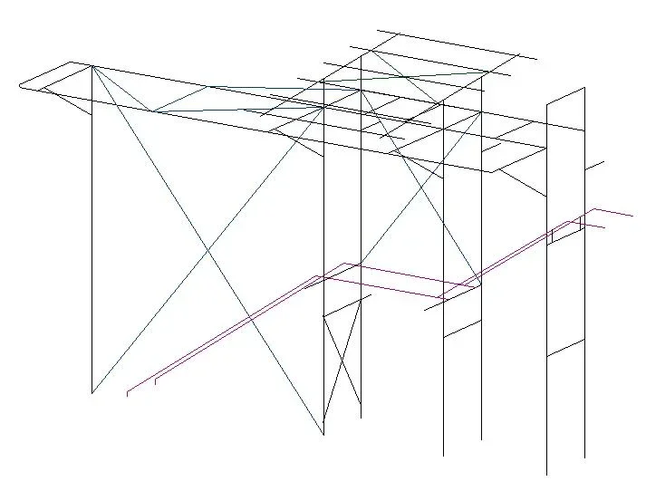

Before calculating a structure I build a 3d model unifilare with autocad which then amounts the model in the calculation program.
It often happens that when designing inclined rods such as the axes of a ladder's cosmos, the terminal points of these rods do not intersect with the horizontal rods of the upper plane, despite the accuracy of the design.
It is, almost always of small errors of some traction of millimeter but, for me, the intersection of the knots and the flatness of the rods is fundamental, otherwise you have problems in the calculation.

this below is a unifilament frame of a steel structure where only axles are represented which then will become steel beamsStruttura1.webpIt is a load bay to inspect the tanks,
on top there is a small tilted roof and in the middle are drawn the axes of the thighs of the stairs.
now, you want for small import errors, you want the copy command of the lines is not exactly aligned with the axes, it happens very often that the lines do not intersect even paying much attention to the design for which, for example the scale does not lean on the below rods. the attempt to correct these small errors leads, generally to worsen the situation, to lose a lot of time and, often to have to remake the design.

in the figure below is explained better what the program does.Struttura2.webphorizontal alignment is indicated by the pq point (quota floor)
vertical alignment is indicated by pq and p2 points
selecting the entities these are projected as indicated by the red color.
