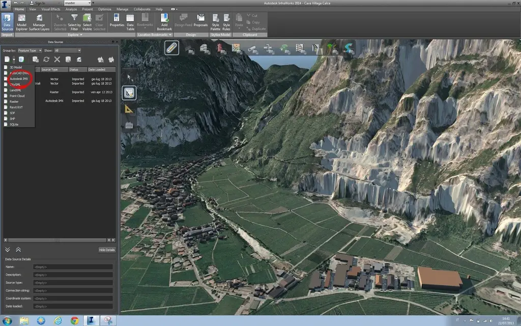

Sorry finibus, question that may seem impertinent but... where are you trying to get there? if your purpose is the tridmensional representation of a city you have wrong software! autocad civilization 3d is not born to do this...
edit: Do you have to do something like that?
practically tristan as mentioned earlier I dgt all elements houses roads etc... and now I just need to create a virtual map. . I even turned almost everything into shapefile.... but I can't put things together... I need to be addressed on a road to go and get to the goal....
Tristan I had the link to see.... I have words... thank you x step by step guide, and now it's time to study. . Thanks again!!! ! !
