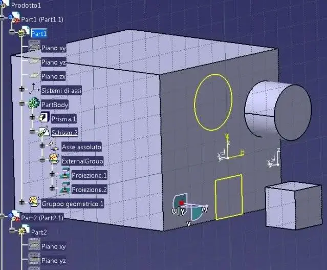

This is what happens when I click on the button:
I then tried to move and rotate on a board part2 and update but it aligns only on the bond of parallelism but the projections as you see remain in the previous state.

in addition to letting the parameterity active (command with shaft and lightning disabled i.e. not red) you must enable this option:
options-->infrastructure-->part infrastructure--> under the curtain "general"-->outside references--->conserve the connection with the selected object.
we waved
the problem was precisely this (options->...), I do not understand why it was disabled, I also tried to restore the defaults but remained disabled.
