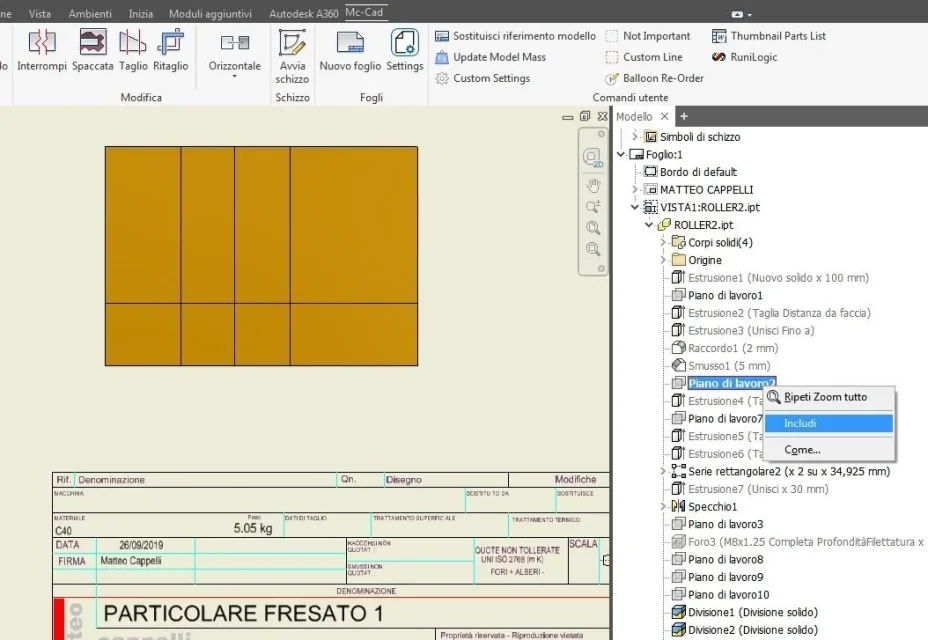

Good evening to all,
I ask you a tip about how to project a plan in a view of the idw.
I tried creating a sketch and projecting geometry, but it doesn't let me select the plan.
Do you have solutions?
Faithful
you need to select from the side browser the work plan you want to include in the view.

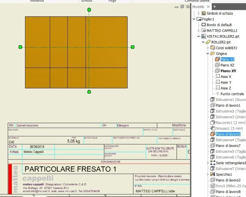

Thank you very much for the prompt answer!
I use the idw very little and never served to project plans, but before making this request I had made a couple of attempts.
After your directions I tried again and the plan I need to include does not appear in the view.
what I had tried yesterday to do and not succeeding I had done this post.
after your directions I tried with others and it actually works.
practically in certain views I can include certain plans and other plans.
You don't know what it can depend on?
does not include plans parallel to sheet 2d but only perpendicular ones
It may be that a plan is not perpendicular to sight.

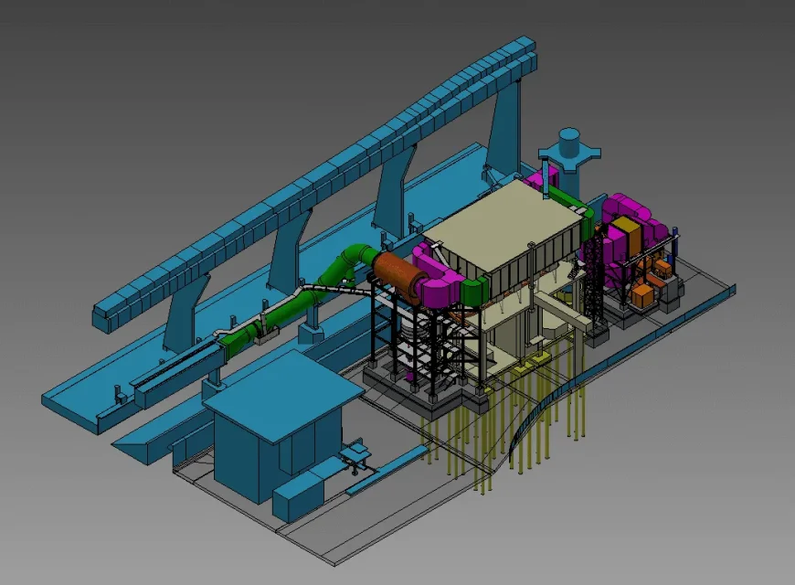

I'm working on a layout of a system derived from a 3d relief made with laser scanners, so some of my reference plans may not be perfectly perpendicular as they come from planes or surfaces that could be slightly inclined.
I had not thought about it, thank you very much for the straight!!!
p.s.
