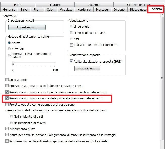

Would someone tell me if it is possible to have the automatic projection of the geometry of the planes when entering the sketch mode?
Hello grace-g axes I already have them active, but they do not allow me to bind the sketch. the purpose of projecting the geometries of the plan axes is to be able to have reference to bind me
you can automatically project the central point, is more than enough to use horizontal and vertical geometric constraints
