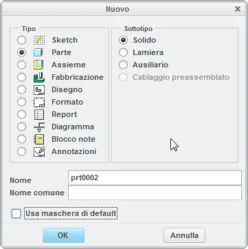

just disable #use_default_template during model creation
hi arni1,
Thanks for the answer but I don't get what I expect, but you made me think.
I did some tests, but no resolve completely:
this is my situation if you disable "use default mask" as suggested by you:1617260711175.png1617260714334.pngI can't find any parameters.
