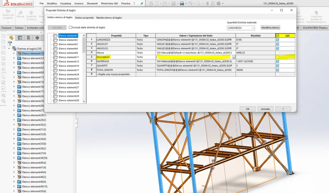

Hello everyone,
maybe what I'm about to ask is a simple and obvious thing for most users, it concerns the distinct cut and the connection of its properties (eg description) to the physical part of the model, instead of manually reporting it. I hope to have explained, place an image for greater understanding.
Thank you as always all for any given answers, good evening.
if you use the profiles of the structural elements you need to fill out the properties of these, then open the sldlfp file and write the description field in the file properties.

hello massive and thank you so much for the answer as always exhaustive,
regarding non-structural elements belonging to the same structure such as plates or folds?
the folds made with sheet metal are compiled automatically, all the rest must be filled by hand
thanks massive, in fact until today I have always done so. I thought there was a chance to automate these too.

This creates additional properties showing the footprint values and compiles the description field in a default way with an identification, for example to me appears plate, followed by the 3 sizes.
if I have a round it always indicates it as plate + 3 sizes; if I want to have in the description only 2 sizes because the length has a dedicated property is not possible. unless you can customize automatic compilation
