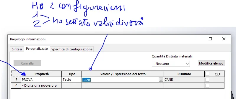

in a test file I created the same property in the "persalized" tab and in 2 configurations
which I set three different values
date = custom dog
date= cat in conf1
date= too much in conf2
now I ask you how it is possible on the table to recall the value assigned to the custom card?
and in the model how can I recall the set data in configurations?
Of course I can't.1638613054089.webp1638613115342.webpas you can see from the image on the table I have no way to withdraw the written "dog" that is set in the "personalized" tab and instead in the model I have no way to assign to the configuration the assigned value, because he always sets the one assigned to the "personalized" tab
Thank you very much
you need to use 3 configurations
prevails the property written in "configuration specification"
You can't use the same property.
in the model you have to create a sketch with writing for each configuration and turn off what you don't need. you have to tie the sketch display to the configuration.

If you have multiple configurations and want all of them to have the same graphics, use the custom card. If you have multiple configurations and want to insert specific graphics, use the specific configuration card. It seems correct to have both possibilities.
in the table call back the property, you cannot select the origin (personalized or config). the configuration property, if present, overwrites the same custom property.
