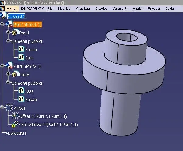

is trying to focus the publication with subsequent replacement of part without losing constraints.
I then replace short part2 with longer part8.
the result is product1.1.jpg where the coincidence of the axes has been lost
replacing part8 with part2 i.e. returning back you return to product1.jpg where the coincidence is connected again.
I also attach catiar20 files.
Can anyone distract me?

check if the name of the published object appears in the constraint definition window.
if this does not happen, the replacement does not go to good end.
when using the constraints published in the execution of the command uses the lebels on the tree of the published parts.
in particular when you are dealing with coaxiality, you find yourself with this mistake of review;
when using the public command, the system publishes the cylindrical face, while when using the coaxial command the axis of the hole and/or tree is used, so the system does not use the published object but another element which by force of things when applying the replacement is lost.
search the forums and find how to publish the axis of a hole.

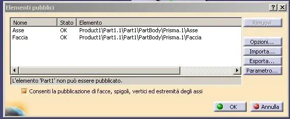

the publication of the hole or the tree is done correctly:
click dx on the diameter, other selection, click on axis.
However, despite this, the name does not appear in the bond window.
"when you use the constraints published in the execution of the command, use the lebels on the tree of the published parts."
I can't in any way make the name appear in the bond window, despite that in the publishing window appear (see photo)
but this is moooooool antipathetichttp://www-01.ibm.com/support/docview.wss?uid=swg1hd52232in this document it is stated that the problem is solved by r18
it would mean that to create any bond, only for the axes you have to go to search in the tree the label, instead for all the rest you can click the element.
the strange thing is that by lighting the axis of the part with the arrow, the label of the publication is also illuminated, as vice versa. Why then doesn't it work in both ways like the rest of the commands?
