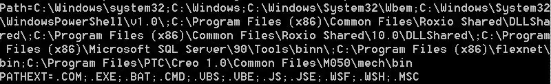

but just to check this path... from a command prompt you can write the set path command and tell us what returns you?
what returns is this, I can’t see more unfortunately from the prompt window
we miss the path where to find the purge, in fact. the ptcsetup can't put it.. Are you PC administrator?
Anyway, let's cut the bull's head. search the purge by browsing the path where creo is installed, should be in your case:
c:\program files\ptc\creo 1.0\parametric\bin
Once you have found the path, go to "Control Panel\System and Security\System" (or right-click on the computer resource icon), then advanced system settings, environment variables.
search for the variable path and add your path of the bin (an eye that takes the point and comma between one path and the other).
restart everything, turn around and after the purge should go.. :wink:
