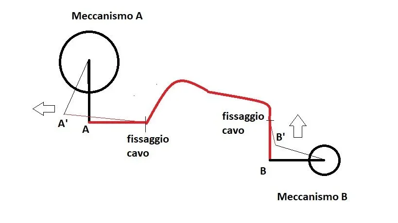

Good evening to all,
Have you ever come across push-pull cable modeling? are cables to push and pull a component.
we imagine having a mechanism with a mobile point e un b mechanism with a b mobile point, initially independent among themselves,
these two mechanisms, subsequently, are connected by a cable, whose path in space, can be connected to a spline with the two straight terminal traits which are bound respectively to point a and b.
Is there any way to relate the move of the point to with the move of point b through a cinematic analysis on creo?
practically, what I would like to do is to see the point at which it moves, together with point b, unfortunately until today I can only move the individual mechanisms a and b.
Thank you all.

[MENTION=69538]320i s[/MENTION] I insert an image to make better what I would like to do.Meccanismo_esempio.webpthe mechanism a and b has cinematic constraints such as to allow the rotation of the biellas, I would like to model the cable to fix it and to bind it punctually in points a and b so as to transmit the motion from a and b according to the runs of the cable and angle of maximum snode.
I would not like to use the mechanism;) because it is all in the definition phase.
modeling the cable and binding it is to all effect a mechanism (see the cable at any point of the guides that moves, not even the mechanism is enough), so the kinematic constraints are necessary, you can make a sudium with sketch and bind them, but believe me if I tell you that you understand things a lot and it will be even more difficult to change the system, instead through the mechanism once defined the constraints in "furba" way (not directly with the geometries definition,
