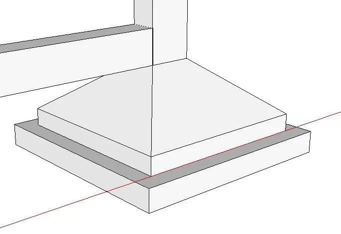

diegolino Guest Jan 26, 2017 #1 I have to draw a foundation on plinths with the classic pyramid shape Is there already a family available? otherwise how can I proceed?
Tristan Guest Jan 26, 2017 #2 create 4 planes of reference, generate a parallelepiped from extrusion between the first two and a pyramid trunk from union between the second two. enough banal family to realize
diegolino Guest Jan 27, 2017 #3 Perfect. the command "union" is very convenient, I solved. Thanks :finger:
