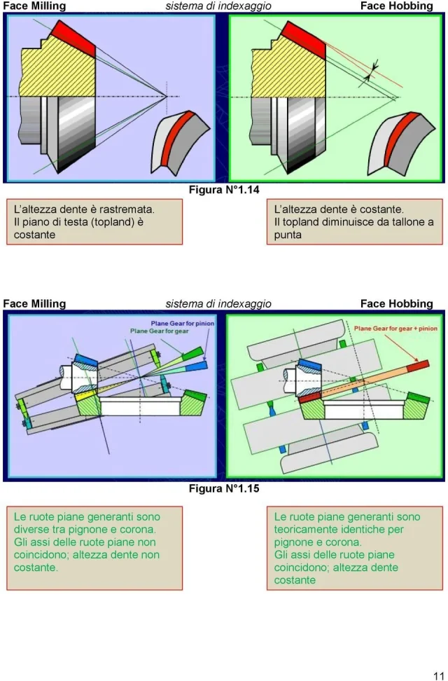

if it is tapered means that the section of the tooth on the outside wheel is large while towards the center is small.... until zero at the center.
I attach a very explanatory image (they are conical wheels with helical teeth but change very little).
normally the braked wheels are tapered while the dentate ones with toothing machine are at constant height.
in this photo you can see well the tapering and therefore the section difference of the tooth between the outside and inside.51qHCJl5C6L.webp
