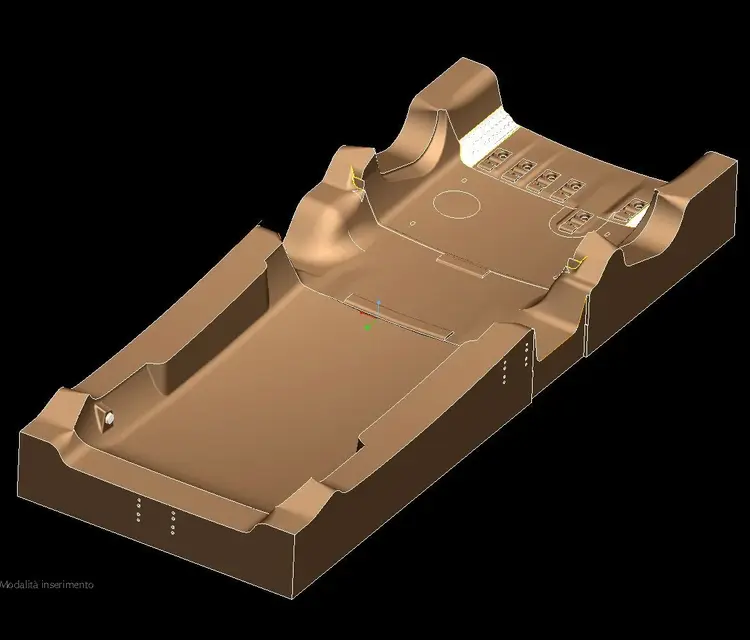

If you mean the cut after mergiating it seems very strange, however you put a photo so you understand.
I'm sorry I'm late, but I'm gonna miss the vacations and the shooting at work, I've deserted the forum a bit. cmq in attachment I put an image of one of the many situations that can happen to me.
do one thing you put the iges file or pattern step, probably the emptying cut doesn't leave you because the surfaces are not closed or well messy.
Did you say the model improved or did you get a top model to perfect?
no I did it but there are many small surfaces that when you make the shell overlap
ragasso, the fault is not pro/e, if geometry sucks or is inconsistent with the shell function you have to fix something to make it work.
