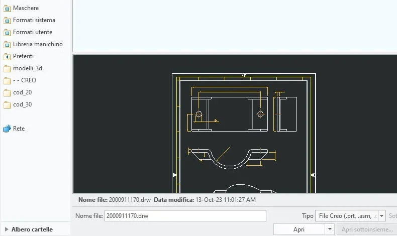

good evening I wanted to ask if other users happened that in the table with relative quotas of some mechanical parts, from which then a set was created using the parts with relative together in 3d put on the table and followed by the relative sheets connected to the parts described above, closing and reopening the program the quotas in the parts have disappeared.
have disappeared both in the table of the axieme and in the table of the single part.
I don't understand if it's a visualization problem.
thanks to all for possible answers

the quotas we create in the table. We do not consider the proposed quotas to be created.
the beauty of the issue that in the preview the quotas are seen, opening the file no.

Isn't that you have a level "dimensions" turned off at level together?
if the level is off, however in the preview the quotas you see them, then when you open the file the quotas "think" because the level is hidden. .
levels do not command the display of quotas and annotations in general. . .spegni/accendi livello has no effect.
Sure?
I in the config set "def_layer layer_dim dim"
and in that level enter all the portions, together, drawing. and I can turn it on/off from the drawing. .
Sure?
that voice creates a level in the table (2d) and in this case I agree that the driving level turns off/light quota level.
I have verified the levels and are active, thanks
