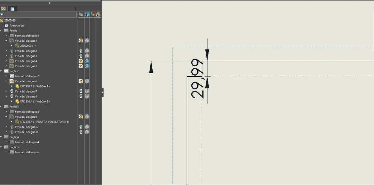

good morning to all I would have a problem with the automatic quotation tool in the drawings.
in the sense that in a smooth view I can quote the edge of the design but not the lines of bending,
You don't select them. .
I press that I've changed work for a couple of months and in the office we just took sw 2022 so I have to set it from scratch.
prma used 2019..
Thank you. .

I put another image to explain, I would like the quota to be associated with the dotted line of bending.. in the 2019 version that I had in the other company was selecting me, maybe I have to activate something but I don't know what. .1669889278672.webp
do a test on system-selection options and check the hidden edge selection box if there is something selected or not.
I add a note, I opened an old design and the bending line the seleziono
I apologize for the continuous notes.
I solved my problem. Involuntarily I disabled the visibility of the sketches and activated only that of the bending lines.
I was so convinced that I didn't check the obvious. .
