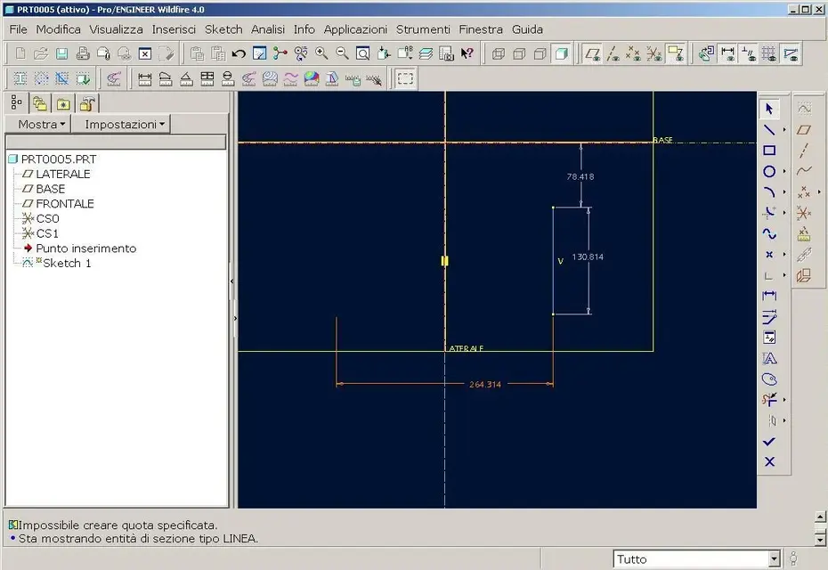

quote ''diameter'' in the sketch of a revolution
  • Thread starter Thread starter mali_fx
mali_fx
Good day to all.
I don't remember how to quote a diameter in the sketch(in the revolution command), i.e. I would like you to quote me as a diameter and not as a radius.
I know it's stupid but for the moment I don't think of:rolleyes:
if it is a circumference or a circumference arc, double click on the curve and then central key otherwise as maxopus says.
if you use wildfire 4 the operation that says maxopus does it automatically with the option sketcher_dim_of_revolve_axis impostata su yes.
instead I had understood it referred to the sketch arches that pro-and automatically quota as rays but sometimes it can be convenient to quote them as diameters.
Anyway, not bad, I gave you answers to all possible interpretations. better than that... ;-)
actually modify the string in the config pro does it automatically.
better so, very comfortable.
