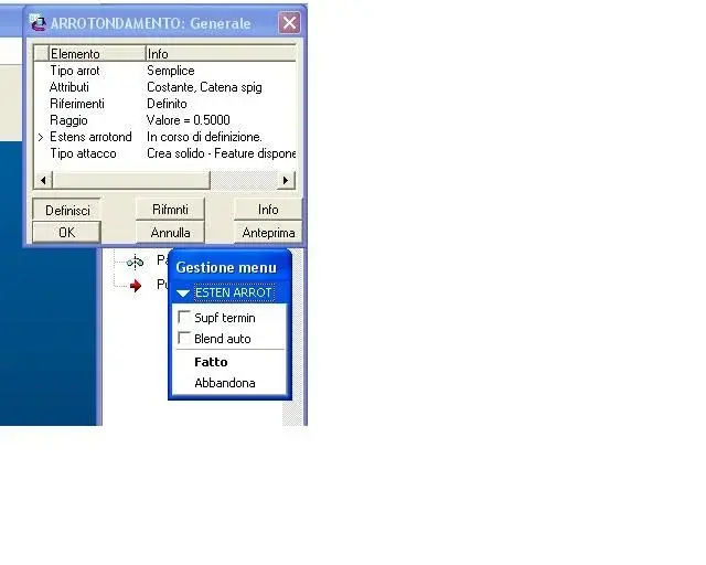

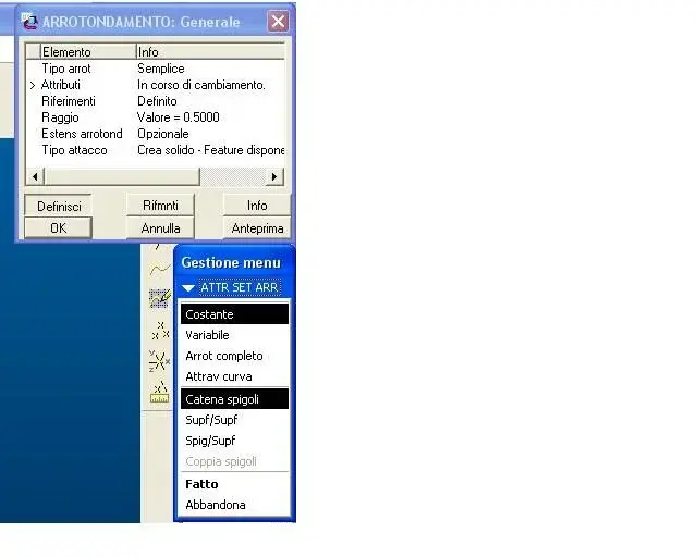

a greeting to all, I noticed that proe wildfire than for example the 2001 version has limitations on what concerns the rays..... To make an example, 2001 had the possibility to choose as an attribute parameter in addition to the edge chain mode, even surface/surface or edge/surface, even if the beam failed, there was the possibility to bypass the problem using the supf termin and auto blend options.
allego exemplifying images

I don't know the 2001 version, but if you want to make a radius between two surfaces, in the wf just select the two surfaces and invoke the command. as for the endings, in the round dashboard there are two icons, the second one allows you to define the transitions and possible partial terminations.
