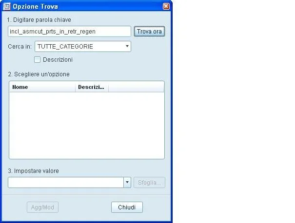

Good job.
edit the config with block and write the line and save
restart proe and charge the axieme
