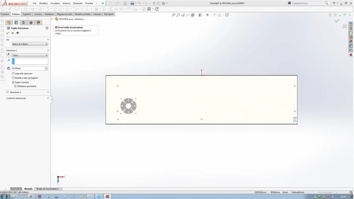

Good morning.
In an attempt to add a compass to the attached sheet, I found the error you see from the screen, that is relative to the reconstruction. thinking it was the only problem of the command of asola I tried to make other attempts with other commands but all (I didn't really try them all, but the most used ones) give me the same problem
Can you help me?
available for clarification
Thank you very much
I can't find a sketch to make that extrusion cut.
instead I see errors in edge-flangia 6 functions and flange edge 7
That sketch, giving me that mistake, I erased it. If you try to make any kind of drawing on any kind of face, it gives you that problem.
I try to recheck those edges-flangia.
