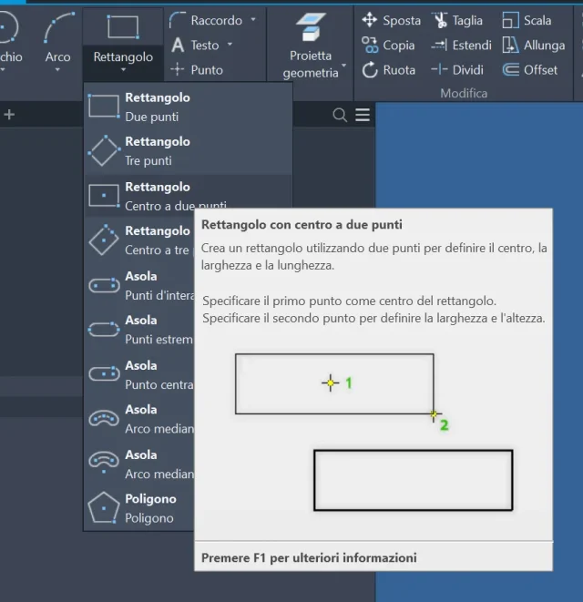

draw a rectangle with central point and aligned vertically or horizontally

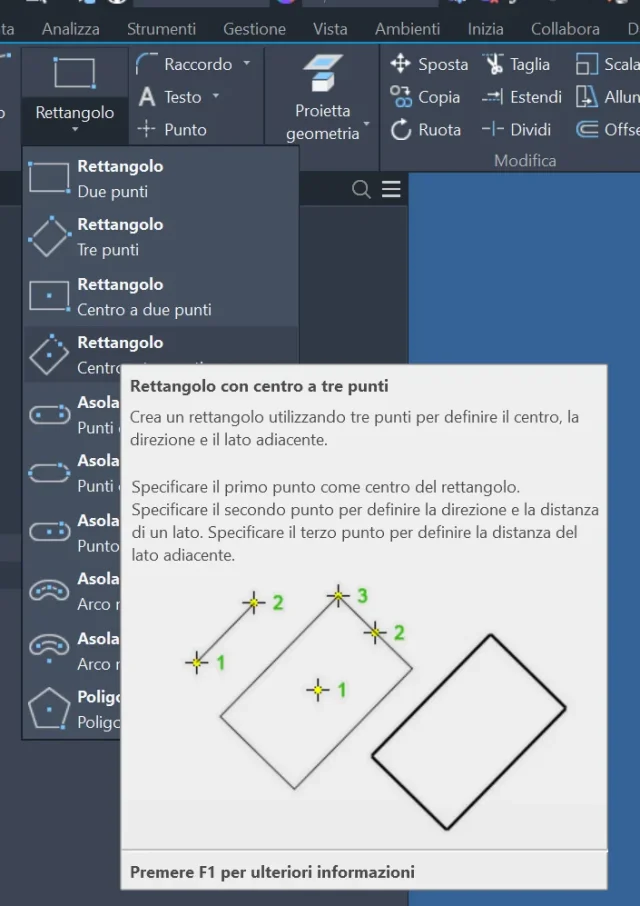

1.webpdraw a rectangle with central point and not vertically aligned or horizontally
2.webpI understand the nuisance, but maybe you're gonna have to get yourself another way.

Sorry. @takes I don't know the add-in in question and I don't want to say fesserie but I think it hasn't been updated for 13 years since in the years they are solutions adopted natively in inventor.
View attachment 70718draw a rectangle with central point and not vertically aligned or horizontally
View attachment 70719I understand the nuisance, but maybe you're gonna have to get yourself another way.
