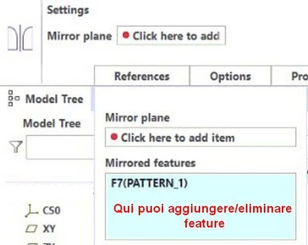

Good day to all, first of all I apologize for the long absence (I really have very little time lately), so I ask you the new extravagant question.
we put the case I have a part or a set within which I realize some work (just a drill consisting of n feature in the tree), at this point I have the need to realize the same work exactly specular and dependent on the first, the easiest thing is to use the mirror command! all right here, the command works and does its duty, after a week I have to make a change to the detail, adding a new feature (e.g. a small cut) that it is always necessary to speculate about the same plan; Is there a possibility to add this new feature to the previous mirror? to better clarify shift the insertion point before the mirror, I realize the processing, reacts the mirror and add the feature to the already present mirror.
Thank you for your help!
hi 320i s, it is simple, I make 3 holes, mirror them, I make a 4th hole before the mirror, I would like to redefine the mirror and add the 4th hole just made.
he did a 3 feature spout, and after a week he adds a feature and wants it to be included in the previous mirroring and auindi wonders if there is a way to make this integration of the fourth feature in the existing specking
ad esempio:
1571401116261.webpin red the one already present, in blue the one to add to the feature mirror.
Okay, but at the end of the first post, write this:
to better clarify shift the insertion point before the mirror, I realize the processing, reactive mirror and add feature to the mirror already present.
in red you have practically answered, so I don't understand where the difficulty is.
do not do with the 3, at least I did not find how to implement the mirroring with the new features
