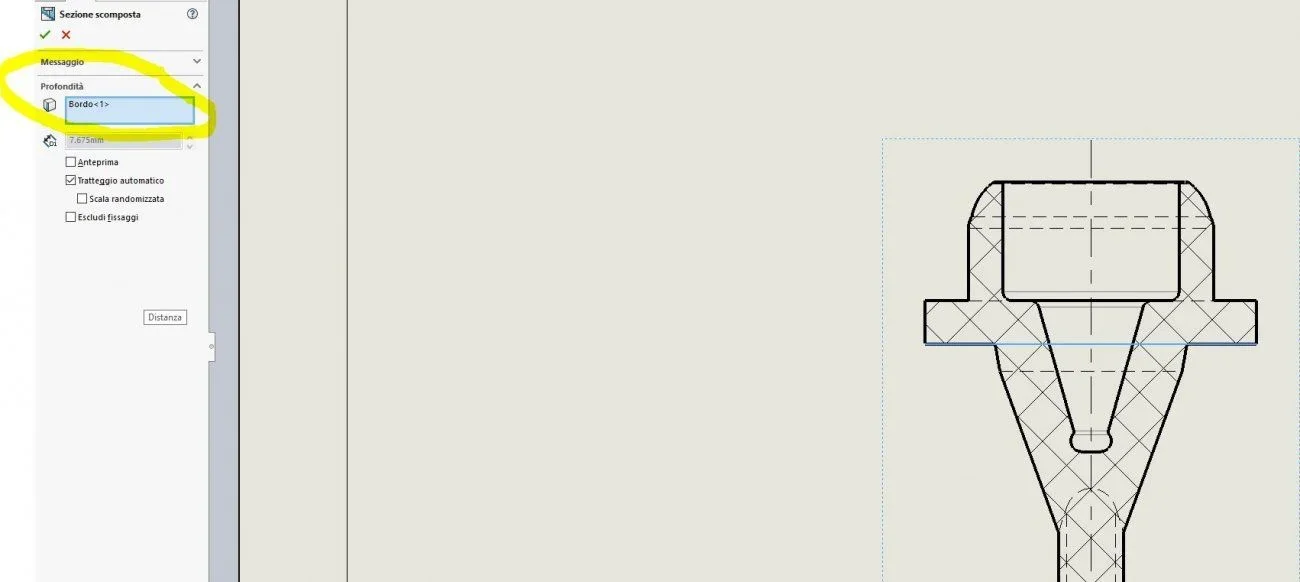

I'd like to see if there's a way to do this.
When I make a blurred view, I see correctly how dissected, but the program doesn't give me the depth reference, is there any way to indicate it automatically?
the program allows you to:
you have to give it the depth reference in the blue depth box (see image).
the reference is nothing but a hole a line a point given on another view.
for example in your design you could have referred the hole 5h11 to the view above.
I hope I've been clear

in my case, for example, the section line would be the horizontal half-work of the hole ø5 h11
never seen a decomposed section with the reference of the section line.
and then how do you indicate the reference?
however said my exists the command creates section line insert>create section line
They are very simple broken sections, it doesn't seem anything special.
create for example makes you do the normal section and then allows you not to dissect a part of the design, but obviously leaves the section line on the design "father"
but the broken sections do not require a reference line that contextualizes. I've never seen him anywhere. If there is a norm, then I'm wrong to do a mea culpa
also because if you draw the reference line on the hole ø5 h11, this line takes a reference letter. how do you indicate this reference in the section? with a note?
Anyway, let us know if that's what you need.
