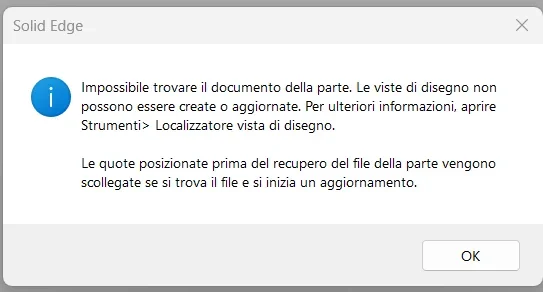

I would like to know how to dissociate a part from a table. I'm preparing standard carts and to do so I put a part in the table with a series of custom properties, now I would like to save everything by removing the part to be able to exploit the formats freely, but I don't understand how to do it. Meanwhile I thank anyone who can give me suggestions or solutions.
if the year calls inside the path to the file means that they are "appointed reference" if instead they are similar to "{%namepropriety|r1}" means that they are "reference index"
are of this type "{%property|r1}"
in the opening of the standard draft I see this message
I'm trying to put everything back on new

but from the sketch tracker what does he say?
Isn't that you put a view in one of the backgrounds?
where do I find the tracker seen? I tried to empty all the backgrounds. However by doing the 0 format doesn't give me the problem. Strange.
