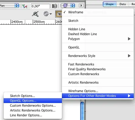

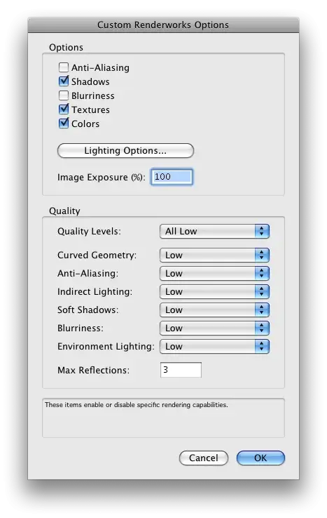

Well, there are some specific options for each type of rendering and you find them in the same menu that allows you to launch the rendering;-)
considers that renderworks uses the c4d engine, so it is not very simple to "domestic" but can give great satisfaction.
Obviously, you also have to place the sun or other types of light sources to get shadows.
