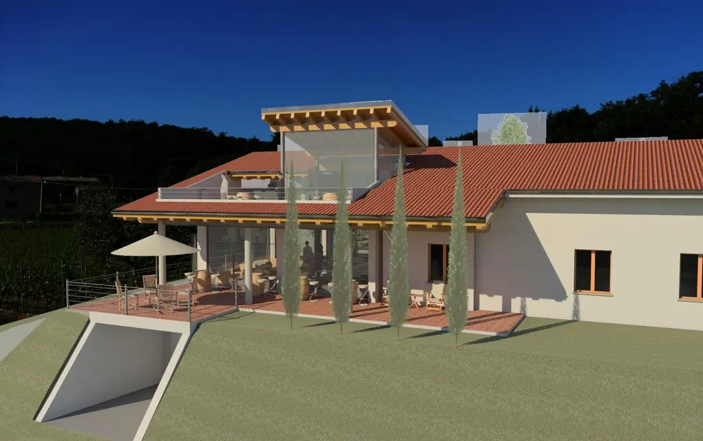

Hey, guys! I have a problem to solve I hope to write in the right area of the forum (if so not excuse me!!)
I'm making renderings in optimal quality with revit architecture 2013 but I have a problem that exists between the background image I insert and the RPG of the green of revit.
practically a sort of "square" is formed due to therpc and is not in what way to remove it. (I attach an image to make you understand)
Thank you in advance! !
the plants in front do not give problems to what seems because they insist on the object,
are the rpcs behind that insist on another image.
Because I don't know.
However, since nothing would remove the image due to their marginality and size
Take them off.
for me you should also change background or take the image used and make it readable by clearing it with a paint program
ps. for cad3d
but 500 messages do not win a plush?
Thanks for the answer! !
the image is dark because I have rendered in a high quality by using autodesk 360 rendering (it is not because it so darkens the image)
Let's say that so is unreal, you should send it back to without background image, with the sky of revit, ask for the image in png so you do the background as alpha channel and insert your background after with a paint program
