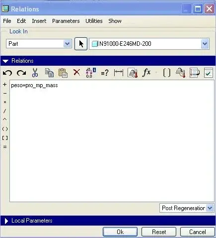

try to insert the relationship into post-rigeration,
or in the reports menu, under the editing window there is a drop-down menu. If you choose "post regeneration" and edit the relationship there, this will refresh you to every regeneration.
I hope I've been clear, I'll tie you a screenshot.. .
hi I found "post regeneration" but I didn't understand how to edit the report. Could you please make me a screen?
You just need to write the relationship as you did before...practically change the sheet you write on....
